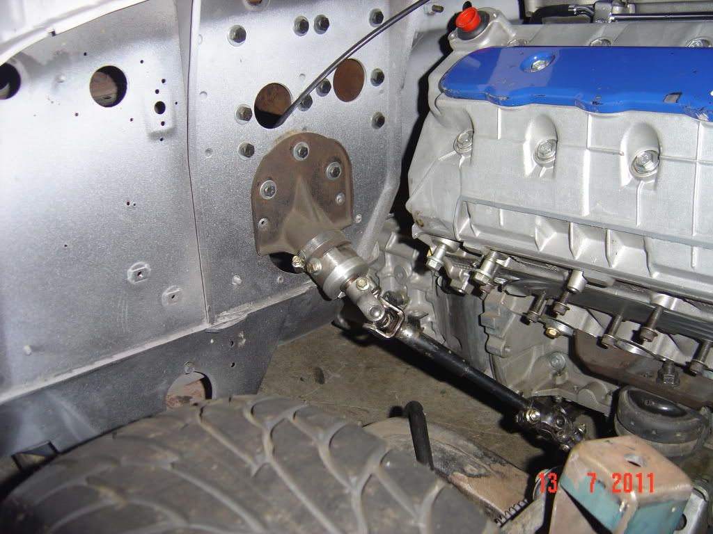

streering wheel on the right sideImage

steeringImage
