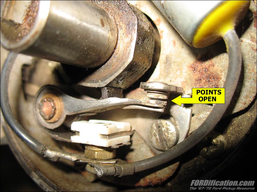

You mean besides the points?broncbuster500 wrote:...Is there something inside the Distributor that would cause this? ...
If the points are worn or loose, that could definitely be why you're not getting any spark.
You get spark when the points are closed...nothing when they're open. Sounds like you simply need to adjust 'em.

i had nothing but trouble with points.. i got a petronics from the local parts store and that made a HUGE difference with performance/reliability. I too suffered from no spark syndrome 2 days after purchasing my truck.. the points are easy to adjust but the 100 bucks for the petronics is even better
