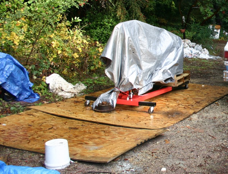

There she is! She's suspended up off the ground by nature of being on that pallet, and the pallet is resting on the legs of that engine hoist. Then I taped a plastic garbage bag around the carb plate to try to seal off the holes. Then on top of that went one of those plastic, silver tarps. And then another larger tarp is covering the whole deal, including the engine hoist.
Is this the kind of tarp ya'll are talking about when you say that it's no better than having it left out in the rain?
As far as I know, no water is directly getting under those tarps. They seem waterproof. It's just that there's a lot of moisture in the air around there.

Well, its not that you dont have it covered, its all the moisture in the air. My 429 was covered in an engine bag & I had a tarp over it as well. I didnt have the intake on it & the freshly "cleaned up" heads were starting to flash rust from moisture. I had it oiled down to no end & it still did it.

yes that is still a tarp. they can let moisture through them. they can also produce sweating inside them as well as could most everything else that is put over it.

If not put some clear "painters plastic" inder the tarp. You can also get the desicant (sp?) and probably a inexpensive heater strip / dehumidifier at a firearms store. Look near the safes.
Since you can't really fog it you could put a small amount of oil in the cylinders and turn it over to coat the cylinder walls with oil.
