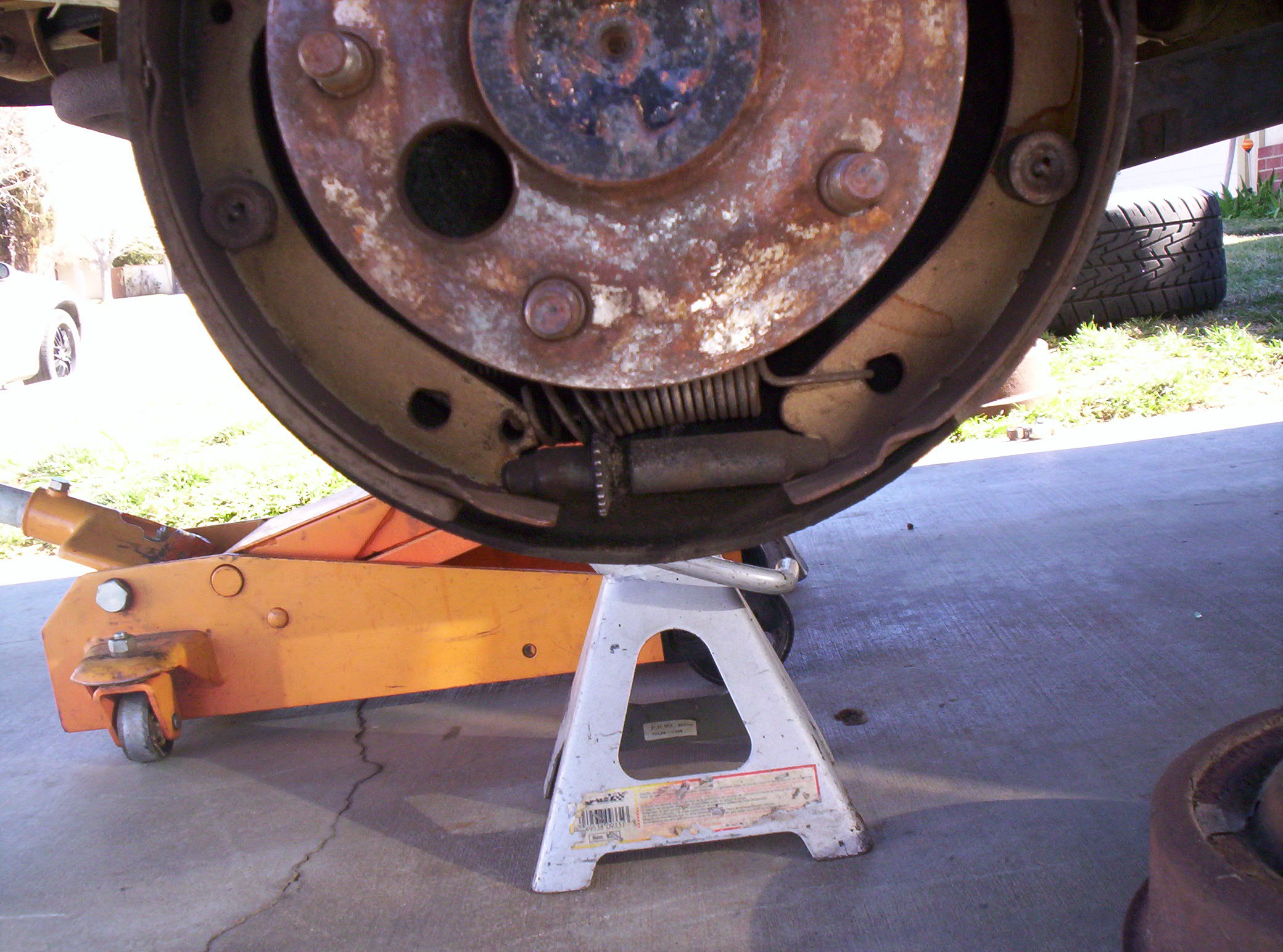

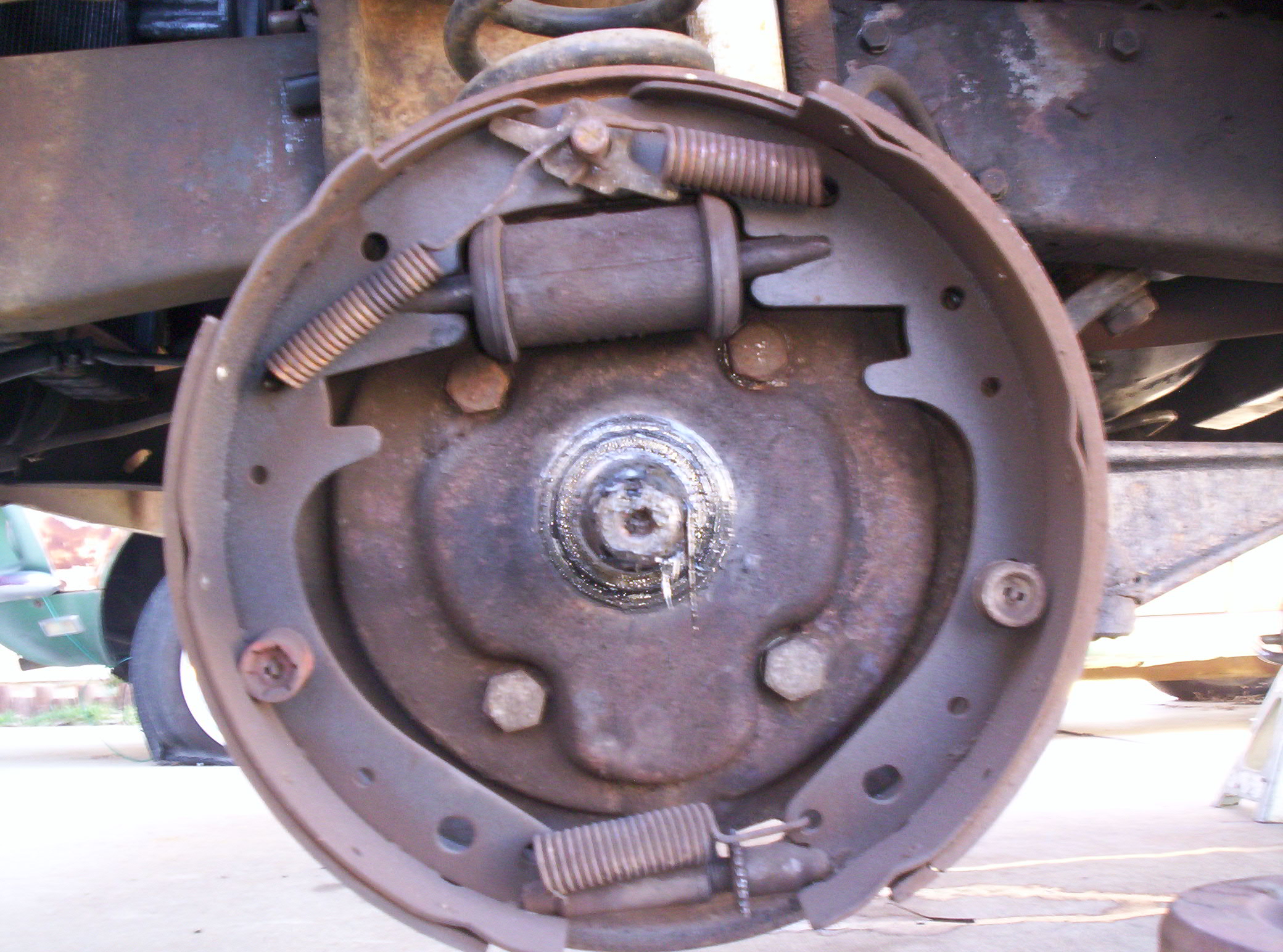

aster a week I had her putting a better carb on her ran hell of a lot better I wanted check the brakes out !!soo i pull all wheels off the rear drums and WTF theres no adjusting levers or cables or the guides and on the pass side the spring was broke and mickey mouse in!!!now thats the rear !!The fronts well the same thing no adjusting lecers or cables or the guides. The drum on the pass side must of came from a 66 and down as it did not fit on there right being spaced out with a old bearing seal so it did not rub the backing plate
whats wrong here do you see it
well I put all new hardwere on all four and new wheel cylinders as well as they look like there were about to go and a new master I found a drum and hub at a salvage yard for 40 and a lot of other parts yesterday!! (Oh and last week Ecology Auto Parts had there 50% off week end and got alot of good stuff) this thing stops good now and no worries now!!!
