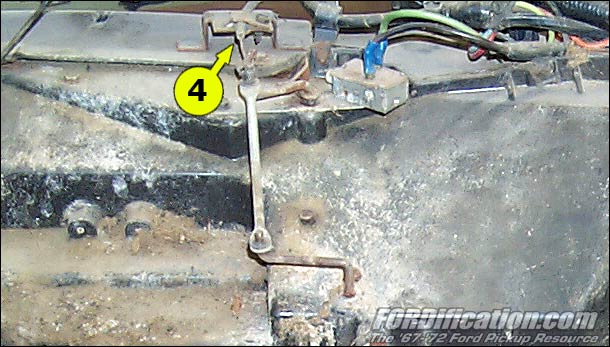

without doing a bunch of pictures and a whole entire wrtie up. basicly the clutch has magnets (field coil) inside of it. first picture. the clutch activation switch is in picture #2 i am unsure about arcing. that tells me it has a bare wire grounding out. i am unsure of his description.

There were two types of clutches used on these trucks.
One had a stationary coil like the one shown in Fordman's example.
The other type had a rotating coil that was energized by the brush assembly that mounts on the front of the compressor.
My guess is that you have the second type, and that the arcing is coming from where the brush assembly contacts the clutch.
You can use either type, as either will work on both York and Tecumseh compressors. The only requirement is that the groove in the pulley has to align properly with the other pulleys. I personally like the one with the stationary field coil, because there are no moving parts, other than the bearings, to wear out.
