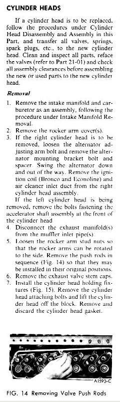

While I can't answer all of your questions, I do have a copy of the 1972 Ford Truck Shop Manual.
From the 302 section, here are the instructions for removing the heads.
Page 21-21-11:

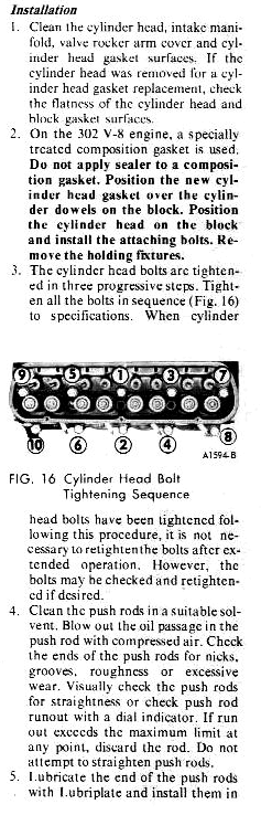

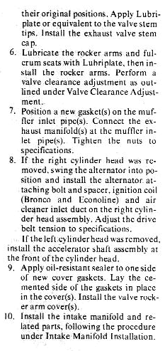

And here are the 1972 302 torque values.
Now that I've provided the sections you'll need from the manual, perhaps more experienced Dudes will provide some real-world advice.
