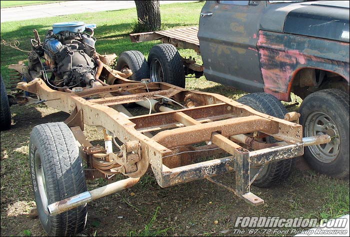

Hey, I appreciate the offer, but I don't think I'd need them for this project. I'm planning on just doing a junkyard swap of front discs and keeping the drums on the back, and then installing a Hydroboost setup.customcrewcab wrote:i have some rear disc brakes and some mustang II parts you can have. just pay for shipping. let me know if your interested. the mustang II parts are to put the bigger brakes on the front using granada rotors.
Some plans HAVE changed a bit though....as far as the engine/transmission goes. I was thinking I'd just drop in the complete 390 I have until it's needed for my '67 project, and then swapping in the 460. But the 460 needs rebuilt, and I think I'd really like to keep the engine swapping to a minimum, so...
...I think I'm just going to use the 302/3-spd setup I have, until the 460 is rebuilt and ready to drop in. It's 100% complete from air cleaner to oil pan, fan to driveshaft, and the SWB chassis I'd be pulling this from even has a full dual exhaust with chrome tips, so everything would be a true bolt-in. That'll definitely help me with the springtime deadline I've set for myself. Here's a shot of what will now be the drivetrain donor for the choptop:
I WAS planning on installing another Camper Special in-frame fuel tank instead of the in-cab version, but since I'm going to need to use the dual exhaust setup that won't fit if I do, I've decided to install the Super Camper Special aft-axle fuel tank I have. It'll require my relocating the rearmost frame crossmember back several inches. (There are several pictures of it HERE, down at the bottom of the page.)

Well, I got to spend another day in the shop today, coating the outer floorpans with POR-15 and then top-coating that with some rattlecan Semi-Flat Black. Got the cab sitting back upright so that I had access to the rear of the frame area, so I could get started mounting the '73-up aft-axle Super Camper Special auxiliary fuel tank.
I've always understood that since the Super Camper Special shared the same framerail spacing as our trucks, that the fuel tank would therefore fit. However, I found out differently today....the darned tank is TOO TALL! It doesn't appear as if it will fit a bumpside truck...unless you want to drop it so low that it's only 6"-8" off the ground.
I was about ready to scrap the idea of using this tank, until I convinced myself that since this choptop truck is a custom, some otherwise frowned-upon surgery would be the answer...so I'm going to be cutting an access hole in the bed of the truck, and the tank will have to stick up through the floor. Since the whole idea of this particular project is for me to 'use what I got', and since this truck is a cruiser that'll never haul anything, and since the bed will be covered with a hard tonneau cover anyway, this is acceptable for this project. The battery will be mounted back there as well, BTW.
