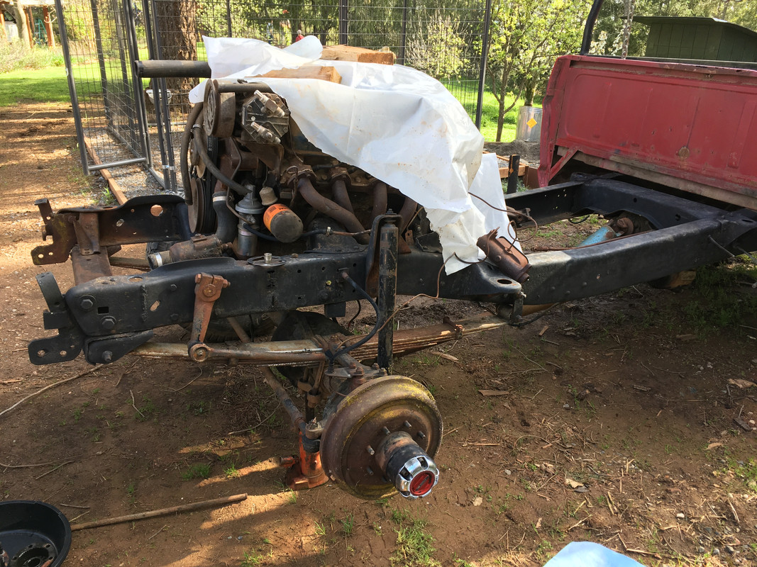

I finally got pics of the chassis and swapped out my hubs. After spending 8 hours in a truck spending an hour swapping hubs was a welcome relief. While I was swapping them, I noticed the axle shaft the hub lock onto had about 1/2 an inch of I<---->I (back and forth) play. Is that normal, or is the front end about to explode? I'd rather know now and not when it fails and I'm doing 55.

Well, I brought my new bed home this morning and have the chassis it was on lined up to be sold tomorrow afternoon.
After spending all afternoon unbolting the bed and cutting the bolts that spun out my dad, my brother, and I got the skiploader and some chains and pulled the bed off and set it to a side for now. I'm focusing on rebuilding the brakes and to that end I got $352.60 worth of brake parts today so I can install them in the next week or so. Depending on how much project time I can work in next week I might get my brakes redone so I won't have to deal with a new frozen brake every time I move it.

After a 3rd trip to the auto parts store as inner wheel seals were forgotten by the parts guy I got the one side finished up and I may start on the other side today if all goes well. I hope now that I have all the parts this side won't take 3 days like the other one did.
The fronts should go quicker as they were gutted 3 months ago.

Rear brakes are redone and the chassis is awaiting the removal of the engine before I wire-wheel it and put a coating on it. In about a week, I will have 3 weeks off from college so I can really focus on just the truck. Hopefully, by the end of August the cab will be sent off to paint along with the doors. We'll see how that goes.
