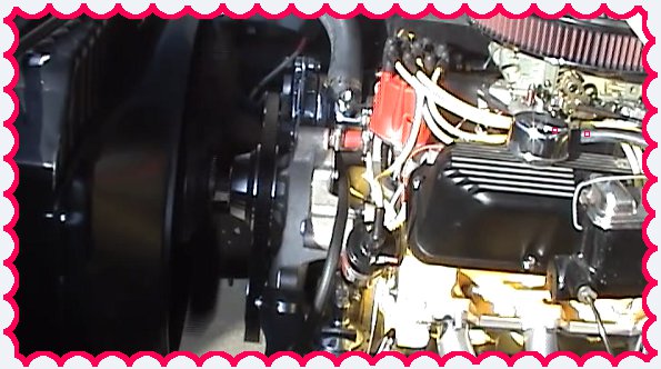

Re: FE clutch fan installation: Hayden 2710 and Derale 17118.
Good day,
Here's a video of the first ever start with the new clutch fan installed. There's a lot of other noise in the video (including some belt slippage), but I figured it might be of interest to others considering this modification nonetheless.
Medium Quality H.264 (10MB) Low Quality WMV (26MB)
Post by 70_F100 »
SAWEEEEEEEEEEEEETTTTTTTT!!!
Always look forward to Robroy's videos!!!!

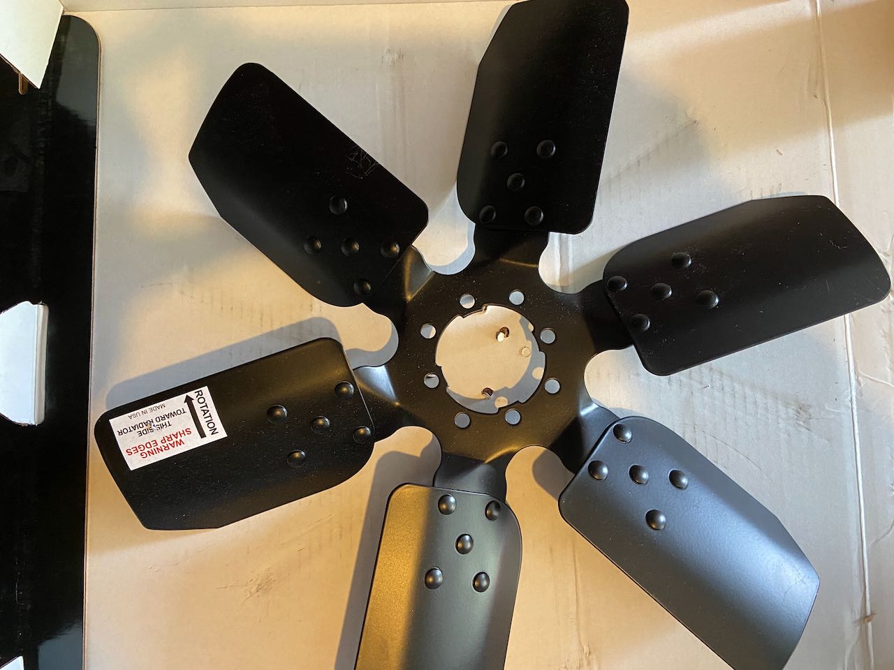

So, i found a loose bade on my fan and decided to replace it with a Hayden Derale combo just like RobRoy.
The Clutch is now "Assembled in Mexico"
Looks like a fine piece though.

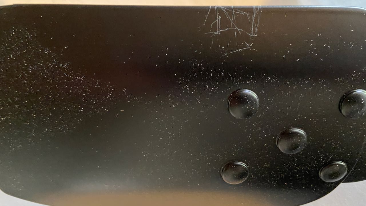

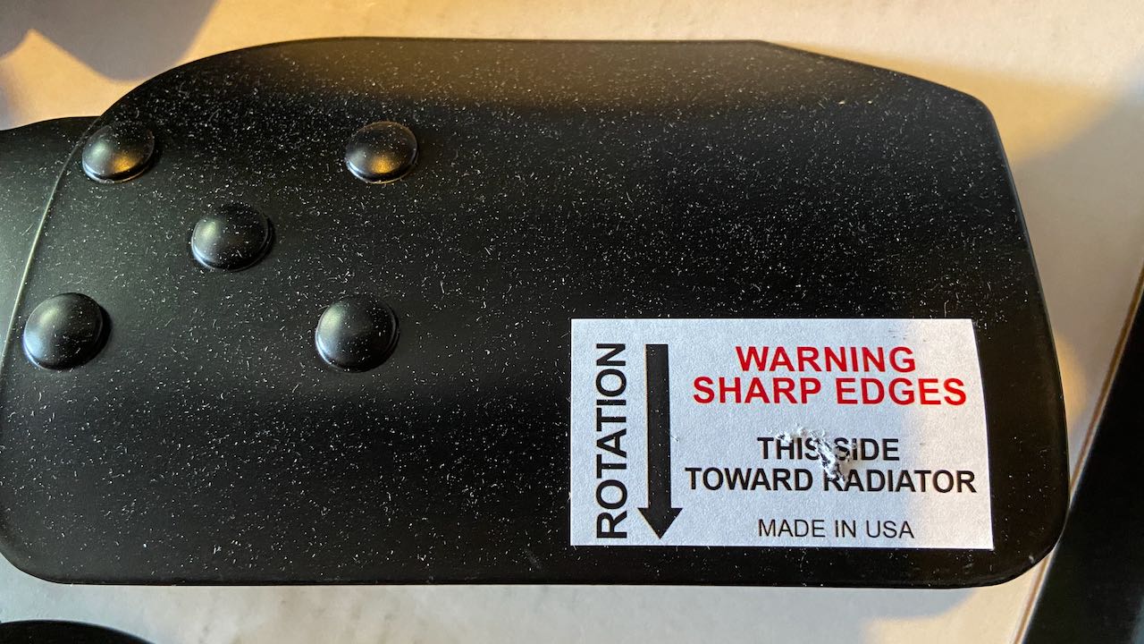

Derale (which took months to get BTW) is made in either China or USA <shrug> and came pre-scratched
Also looks like a nice piece.
Together.
