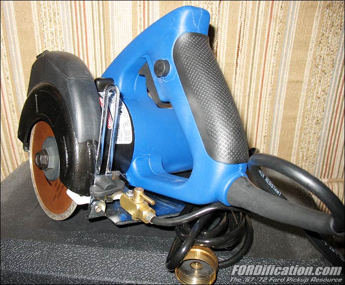

Interesting stuff. That saw sounds to easy to be true.FORDification wrote:I'll be using a water-cooled tile saw to trim down a stock windshield. (CLICK HERE for a picture.) And you can read this thread in which I was discussing it, and also includes links to threads at the HAMB messageboard where I learned about this neat little trick.71 LONG BED wrote:Your progress looks great.![]()
