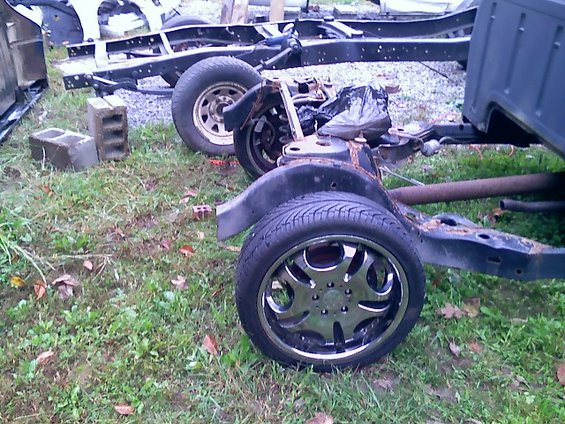

Looks great! I might do this too now... except, I don't see how you got those wide frame rails under the cab... how'd you do it?

The only thing I had to do was notch the floor brace that runs across under the seat where the frame goes and notch the rear of the cab, you can actually see that in this pic...neoxman wrote:Looks great! I might do this too now... except, I don't see how you got those wide frame rails under the cab... how'd you do it?

did you notice the drivetrain bein higher up in the body? Tranny tunnel/driveshaft tunnel especially? I want to do my floor if possible, as its a basic custom job, more so than other things It needs, but I dont want to do it now and have to RE-do it because of clearance issues. I may need to just get the chassis swap done first as the truck isnt at risk to the elements of weather right now.

The actual swap was pretty basic, no? You said only a few things had to be made. Rear mounts for the cab, but tranny mount can be reused/drilled to match tranny mount? I am really looking into doing this after the motor is rebuilt and back in the truck. I want to drive it for a few weeks, and then park it at my grandmas, and do the swap that way, so I can do the frame how I want. Full reinforcement, hydros, wheels, powdercoat...all that first. Get it mocked up/cut/notched and all that of course so everything mounts nicely when done.
