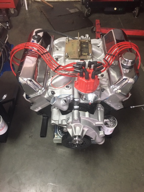

The Mustang was 457 inches, iron head, hyd roller 241/241 @ .050, .630 lift, dual quad tunnel wedge, 545 HP/545 TQ, HP peak was at 6000, shift point 6400. Our goal was 530 @ 6000. This is a very rowdy engine and unless it was in a little F100 shorty with a steep gear, likely not a truck engine
The second, a different story, 14 inches of vacuum at idle, 461 inches, RPM intake, Trick Flow heads, 233 @ .050 intake, 241 @ .050 exhaust, .598 lift, 113 LSA. This mellow monster made 558 HP at 5500-5750 and 594 ft lbs at 4000 rpm. It was a sweetie and would be a mellow monster in any 2WD or 4WD F series.
Hope you enjoy, neither were inexpensive, but the owners should have a BLAST!
