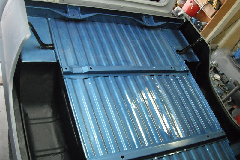

I had planned at first just to clean/scrape a bit and then either POR 15 or rocker guard it, but while I was pounding some dents in the floor out I realized the remaining undercoating (covering about 80% of the floor) comes off in chunks when hit, and underneath there was still the nice factory sealed metal. So, a couple hours with an air chisel and I had it cleaned off. Then I took a spot blaster, drill and a wire brush to clean out the pitted spots, primed it and painted it the same blue as my two-tone outside will have. (of course by the time I took this pic I had done some sanding or something, so everything had a nice healthy coat of dust on it, but it looks awesome when I have it wiped off)
I know the blue won’t be very good with stones and such, so I put rocker guard in the wheel wells.
