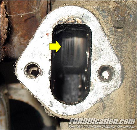

You can just remove the fuel pump and take a look inside the slot to see if the eccentric is still there and intact. Here's a couple pics for the visual:
In this shot, I'm holding the fuel pump right where it would be if the timing cover was removed:
