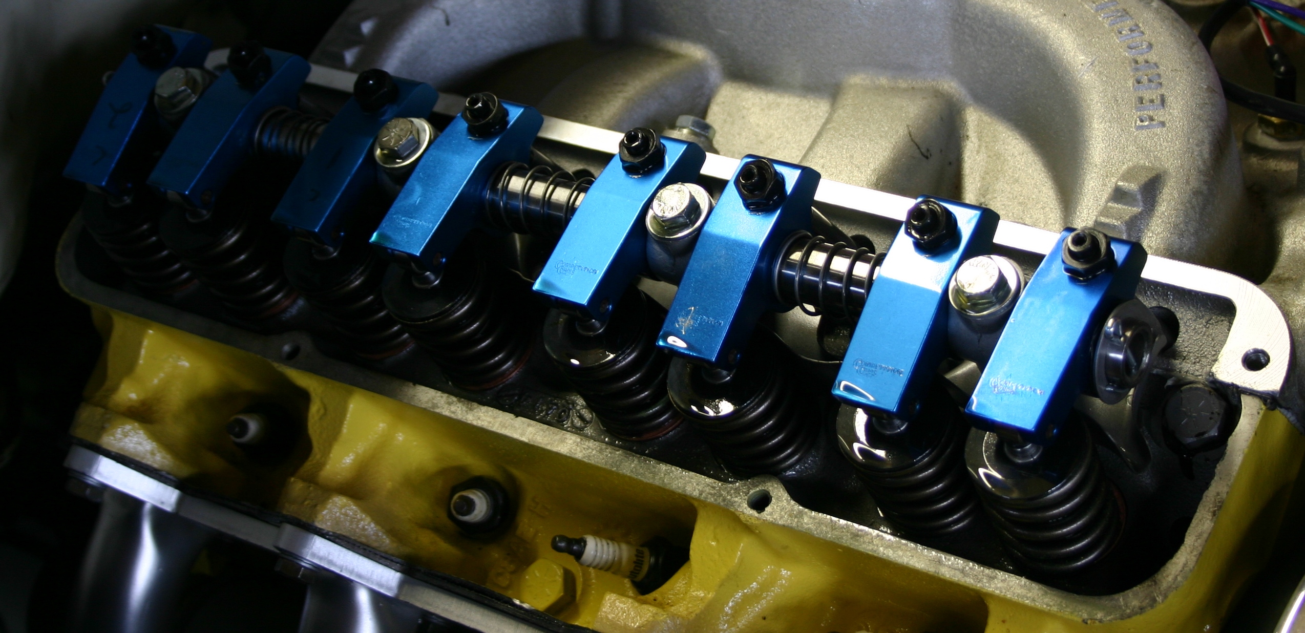

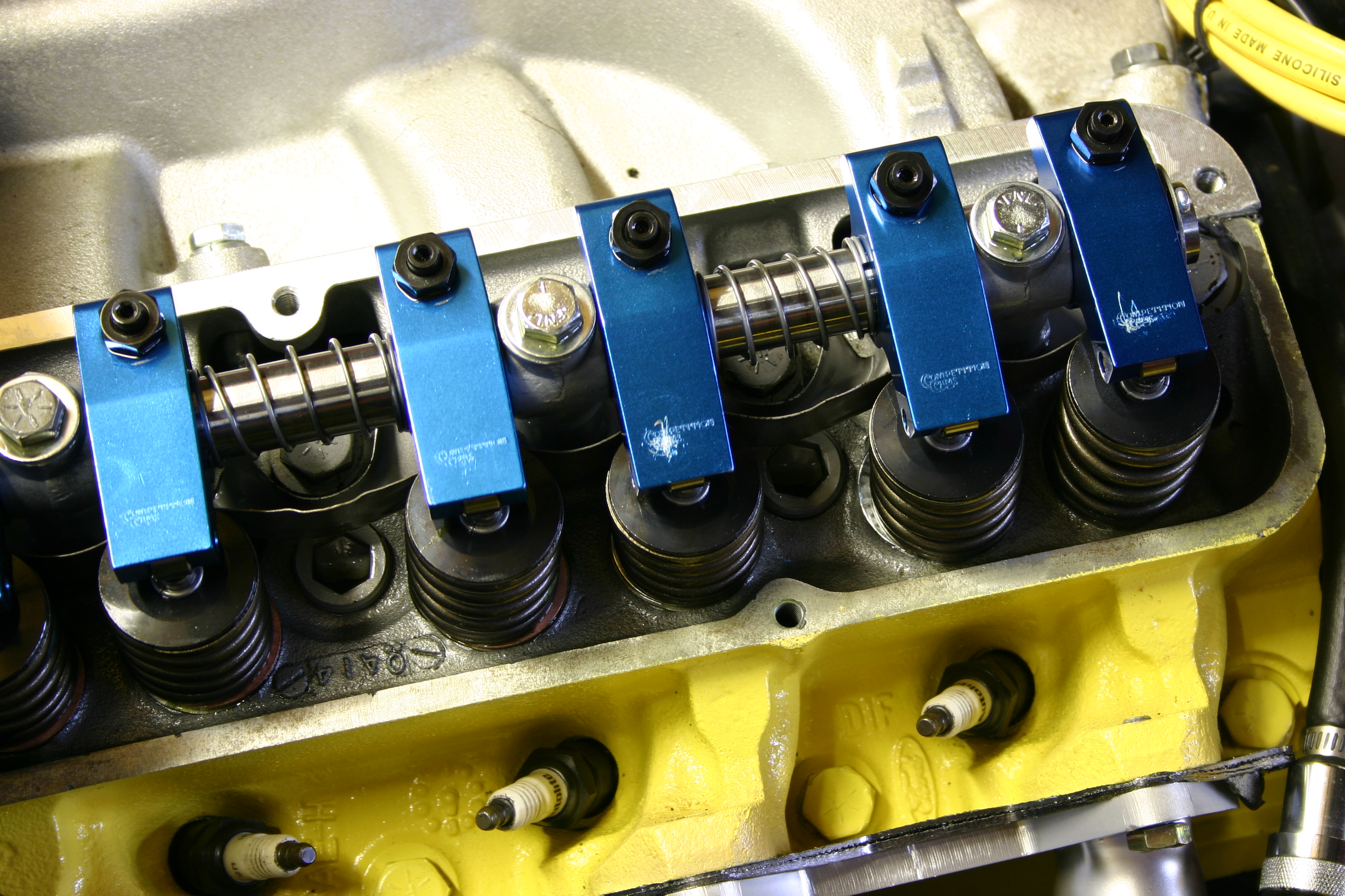

Here's the inspection report for underneath the passenger's side valve cover!
http://www.robroygregg.com/Number50/IMG_4335z.JPG
http://www.robroygregg.com/Number50/IMG_4336z.JPG
http://www.robroygregg.com/Number50/IMG_4339.JPG

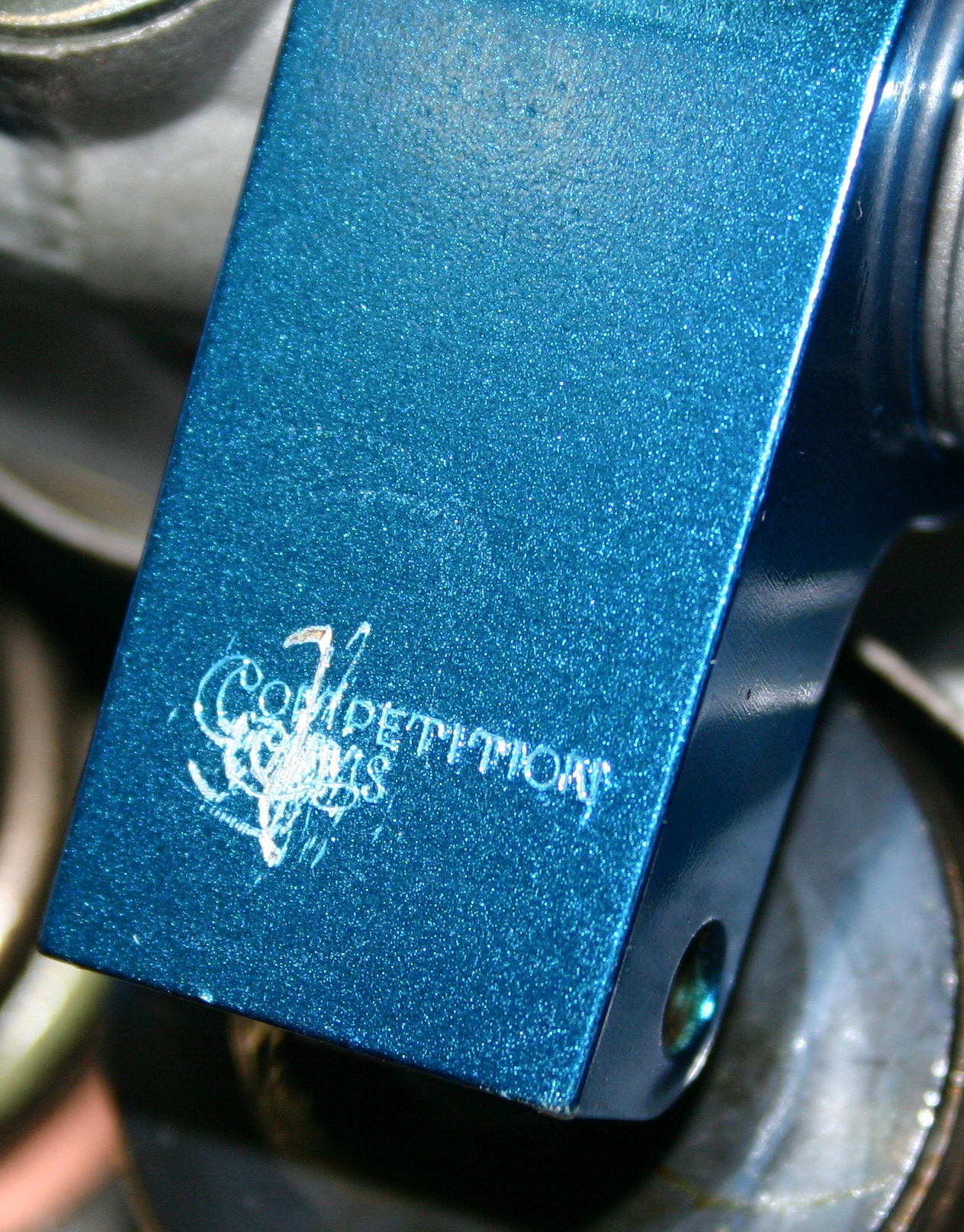

Any idea what these funny scratch marks are in the rocker arm finish?
http://www.robroygregg.com/Number50/IMG_4340z.JPG

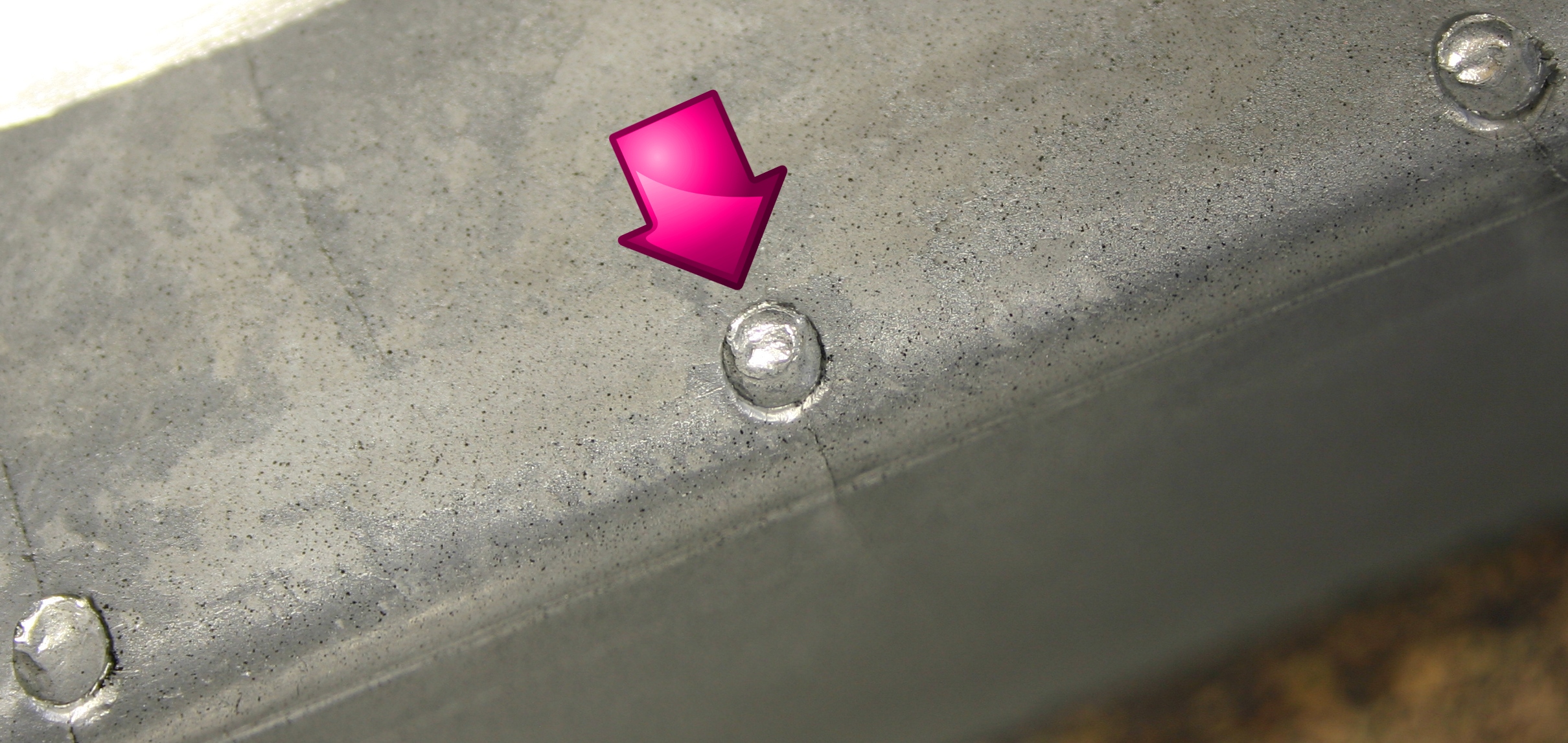

Could they have been caused by these protrusions in the valve cover, perhaps?
http://www.robroygregg.com/Number50/IMG_4347z.JPG
http://www.robroygregg.com/Number50/IMG_4348z.JPG

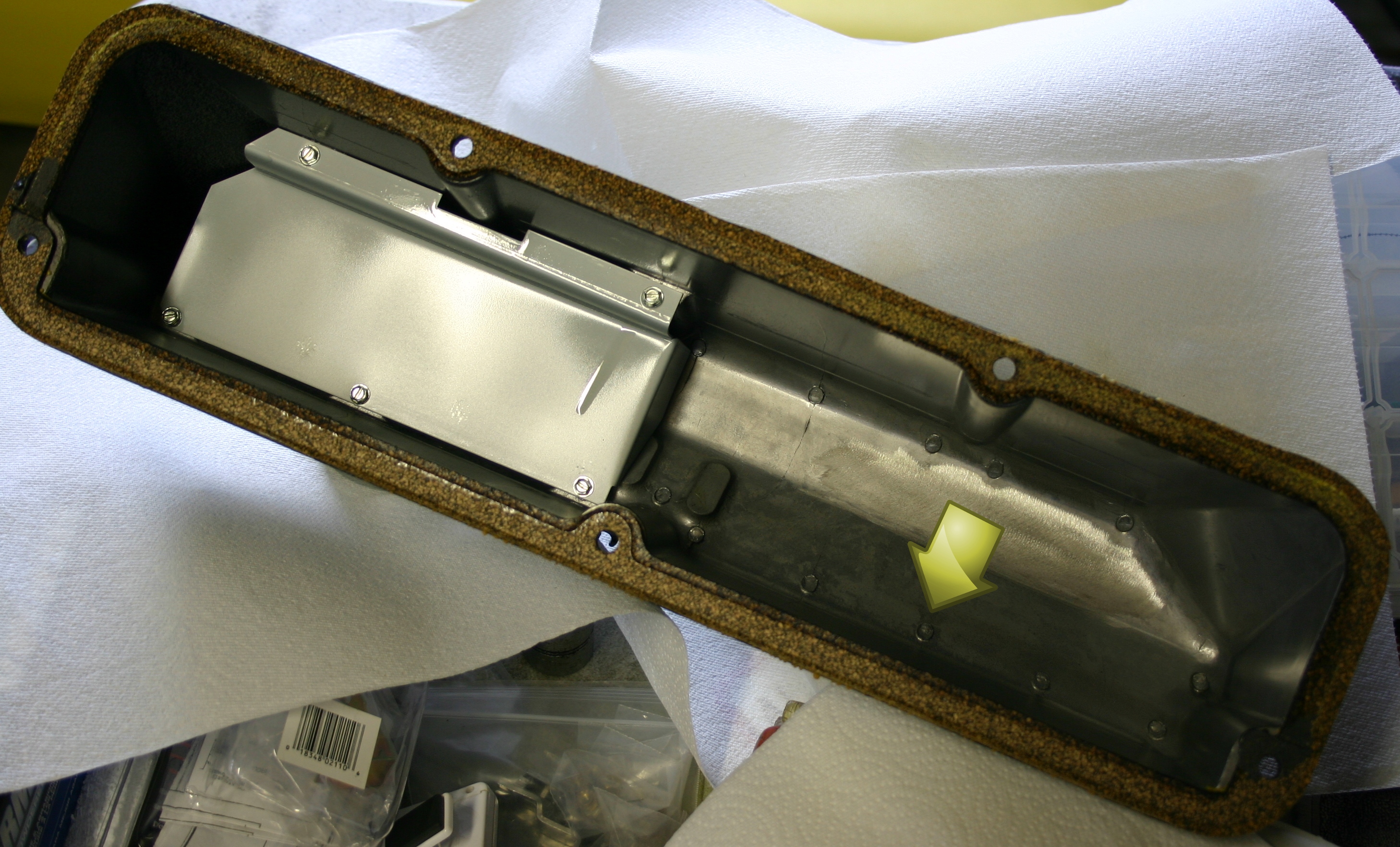

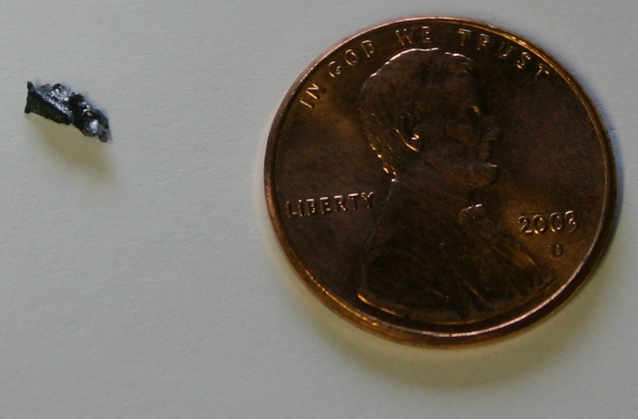

I did find some metal shavings in the area, but I'm not sure whether or not they're truly shavings from my windage tray. Here's the only Moby-Dick I found:
http://www.robroygregg.com/Number50/IMG_4350z.JPG
My reason for doubting that this came from the windage tray is based on its texture and color. Unless it underwent a severe makeover in the guts of the engine, it looks rather different from the "gold iridited" windage tray finish. One side looks blackish while the other side has a dull, raw steel finish.
The other bits of debris were much smaller. Here are the runners up to Moby-Dick:
Then there were some nearly microscopic specs here and there. Other than that it looked perfectly clean, so I'm not sure what to make of it!
Based on these results, would the results from the driver's side valve cover still be relevant?
Thanks very much for taking a look!

I don't think that is from the windage tray... the question is WHAT IS IT FROM?
I'm at a loss at the moment...
You have the arrow pointing to the top of the cover, but it could be the corresponding casting on the bottom...
The good news is that the oil doesn't look like metal flake from here...

Moby looks like a chunk of casting flash (dark grey cast iron) where from? Who knows. Heck, what's another valve cover gasket at this point? I'm not sure about the rocker marks, looks almost like someone was sloppy with a spring tension checking tool but why would you check it after it had run. Wonder what Steve thinks?
