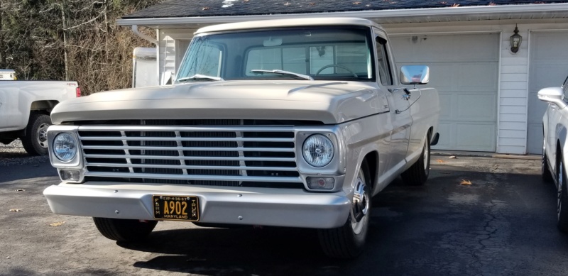

Re: bumps with lowered altitude!! (lots of great custom bumps!!)
Put some DJM Beams on my 69 F250 C/S with a set of Chevy C20.coil springs cut 1.5 coils off
also a 6" rear flip kit with C notch pretty basic kit Although I had the 7/8 king pin so the beams are F100 and they fit right .You do not have the required permissions to view the files attached to this post.
