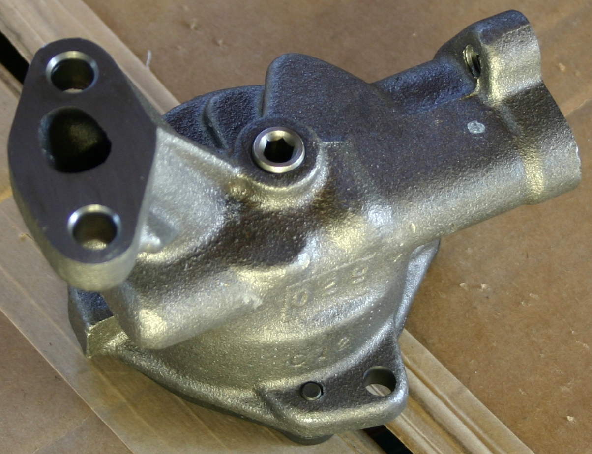

The new Melling M-57HV arrived today, but I haven't cracked the cover off yet to compare it with my trashed one!
http://www.robroygregg.com/Number50/IMG_4371z.JPG
Looks familiar!
http://www.robroygregg.com/Number50/IMG_4373z.JPG

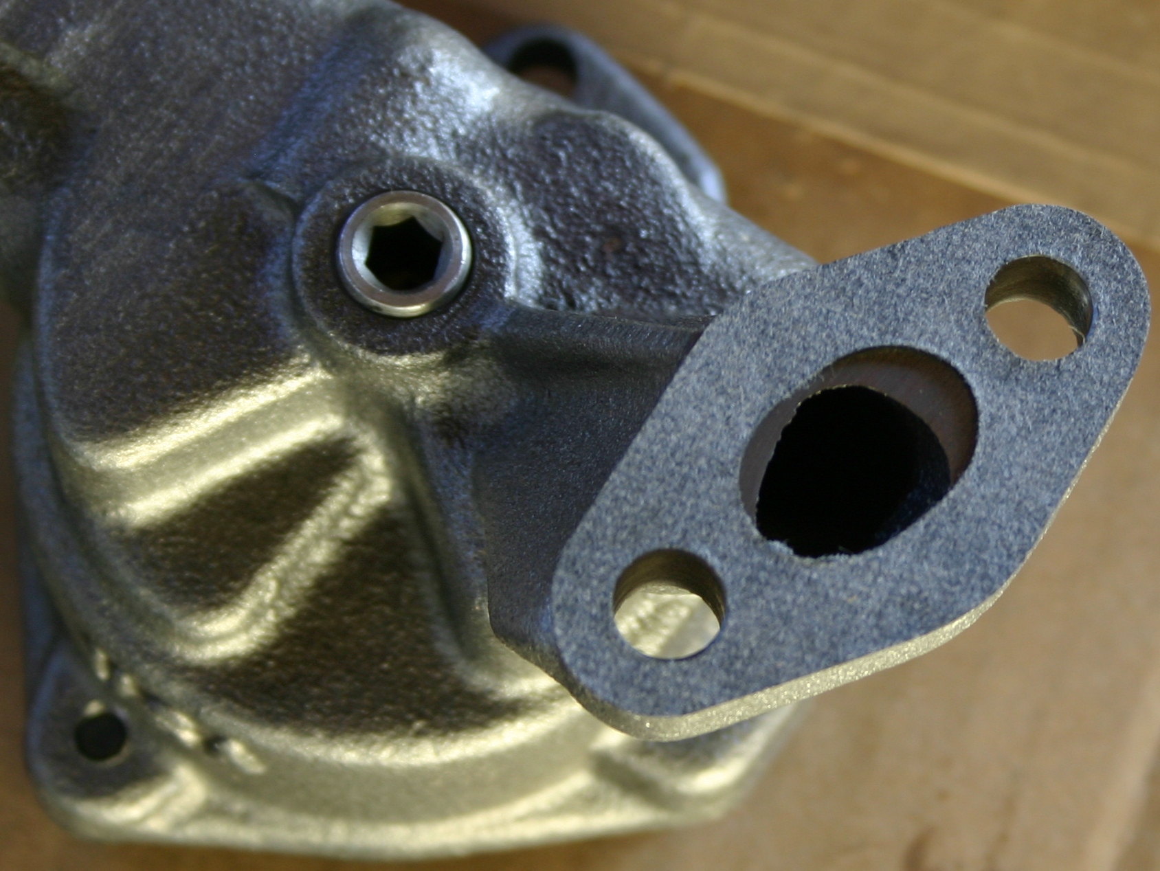

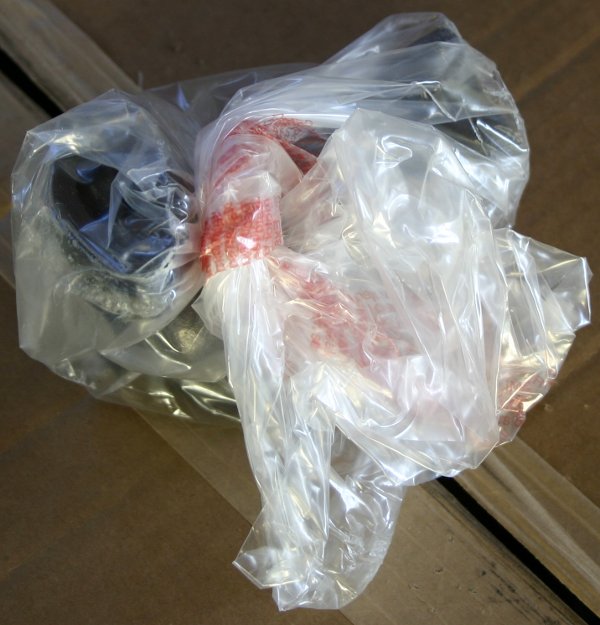

Look at this funny warning! Why in the world would they want me to check clearances, after all? I should be able to slap everything together and trust that the parts were made to fit together perfectly, right? (Just kidding!) It's funny how loudly this slip of paper speaks to me now, after this experience!

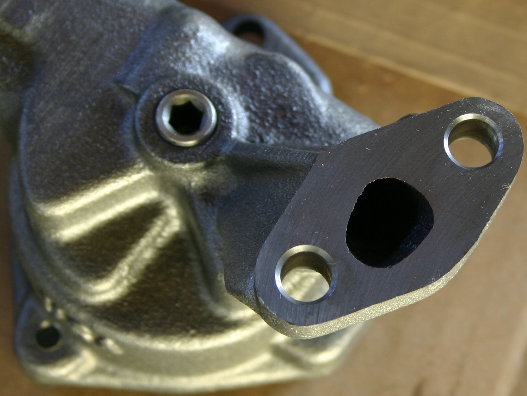

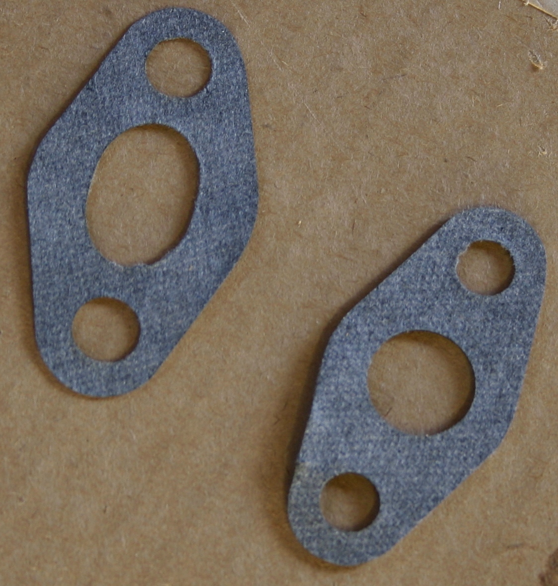

The Melling came with gaskets, thank goodness. NAPA said they could get me the pump mounting gasket, but it would cost $10 and take days to arrive!
http://www.robroygregg.com/Number50/IMG_4375z.JPG
You can see how the oil pump mounting gasket isn't a perfect fit; it blocks part of the opening. I should trim this to fit perfectly, right?
http://www.robroygregg.com/Number50/IMG_4377z.JPG http://www.robroygregg.com/Number50/IMG_4376z.JPG

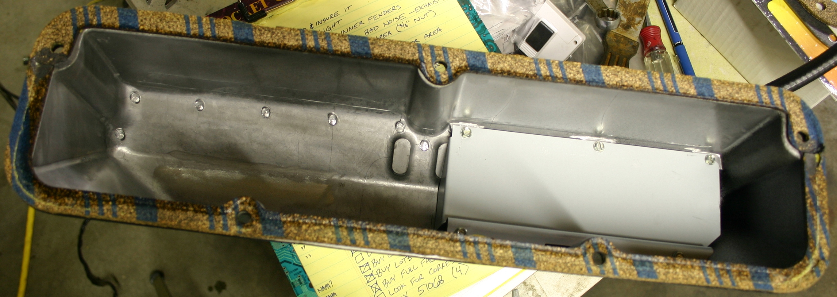

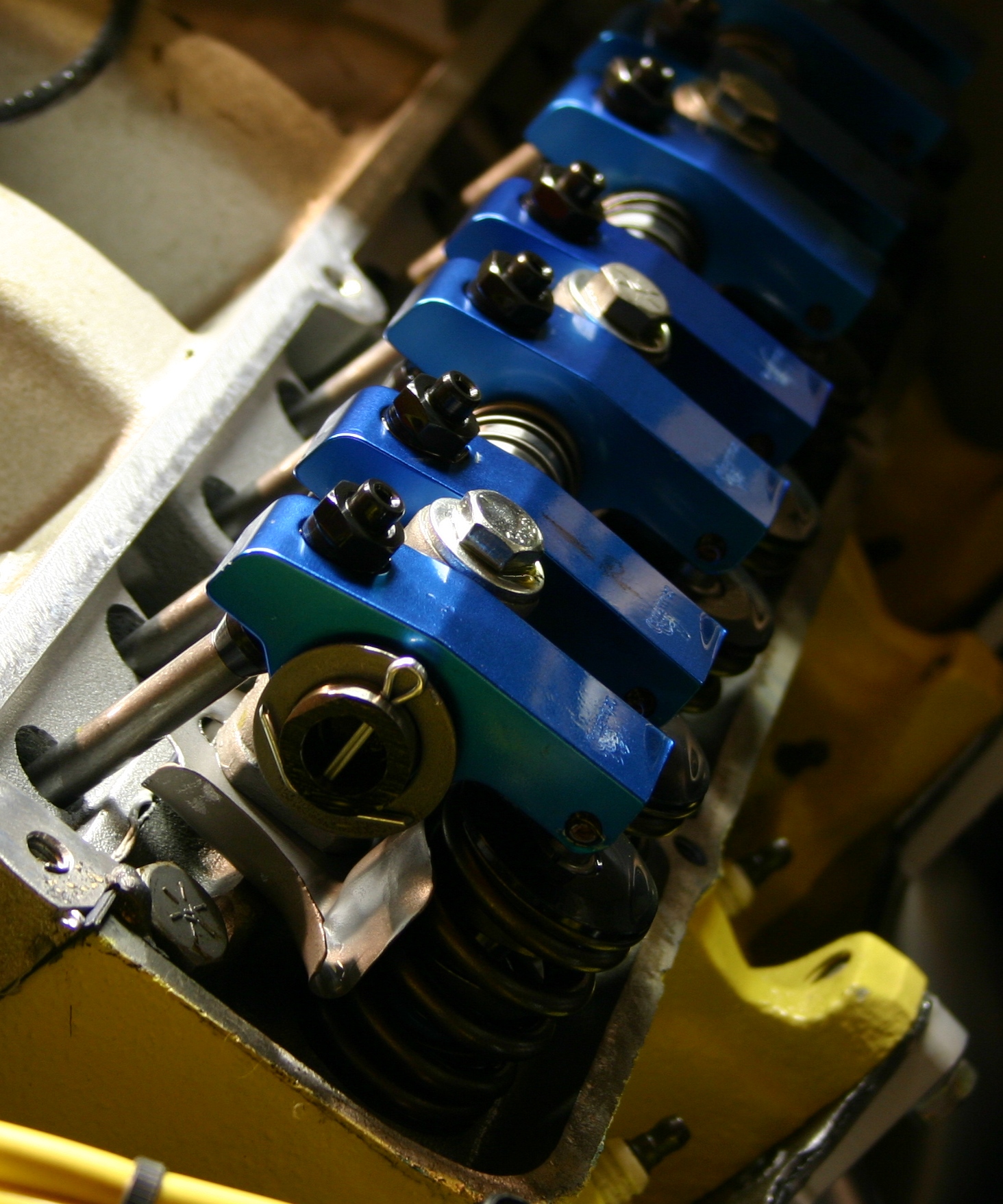

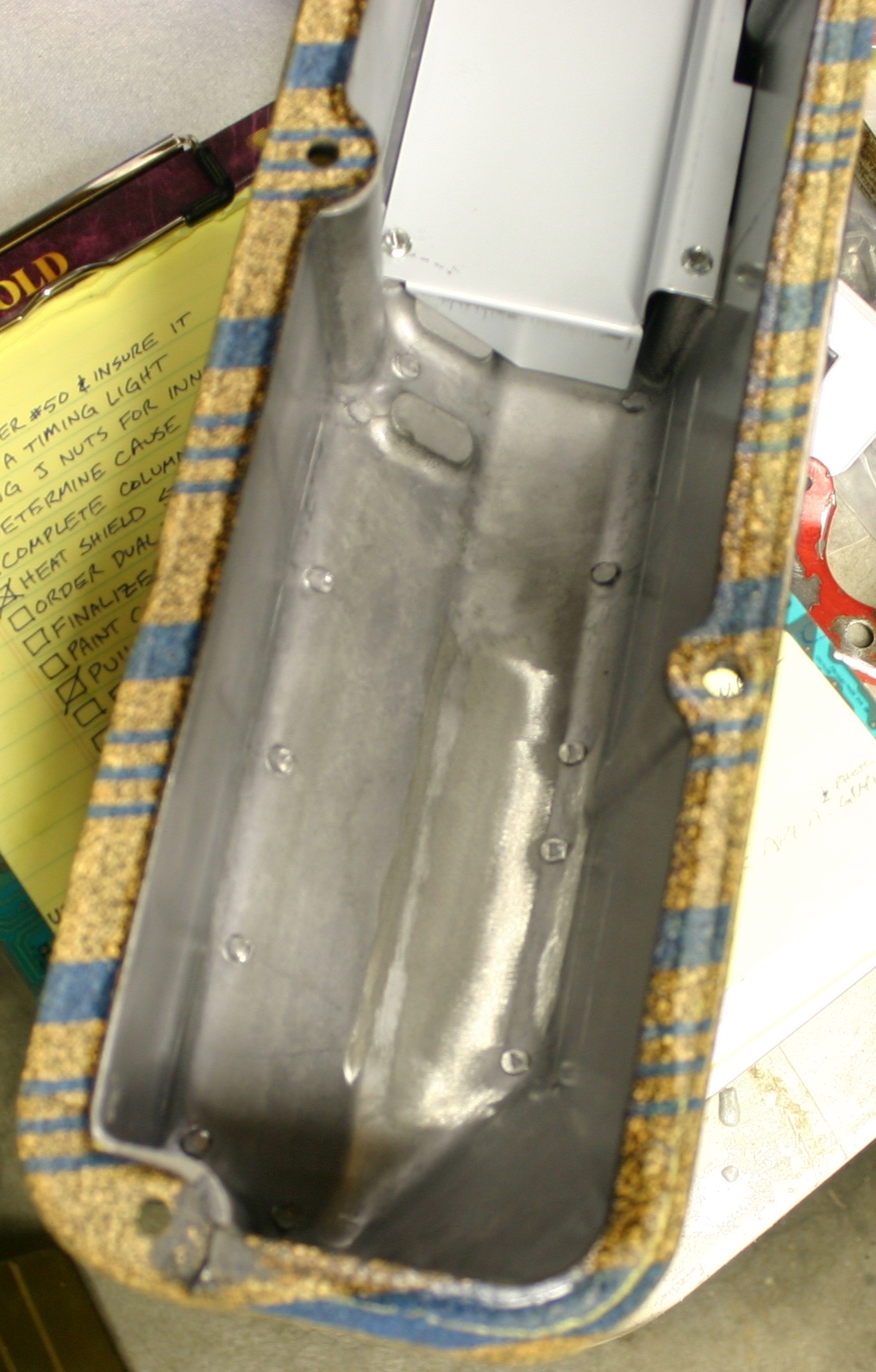

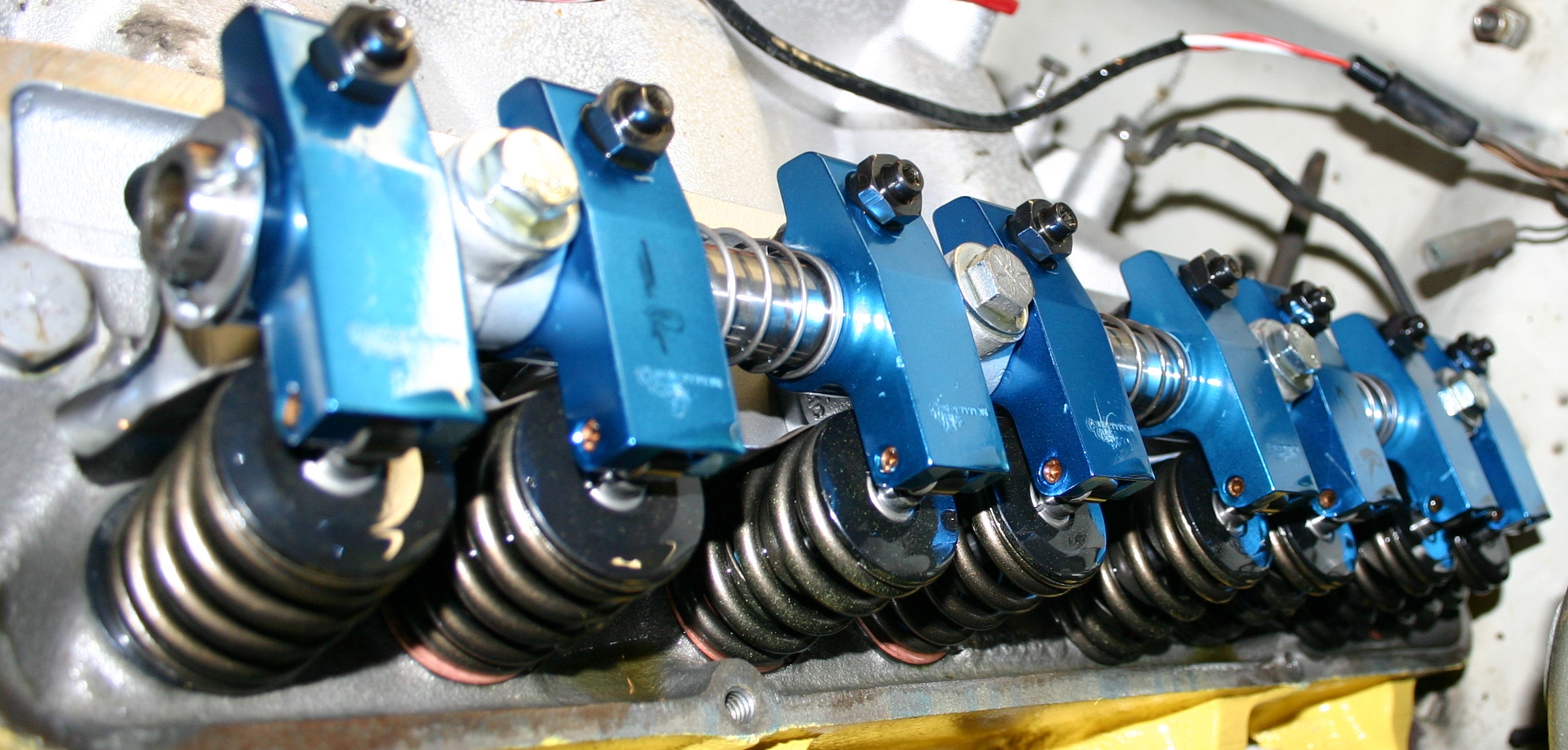

I pulled the driver's side valve cover, and it looked similar to the passenger's side.

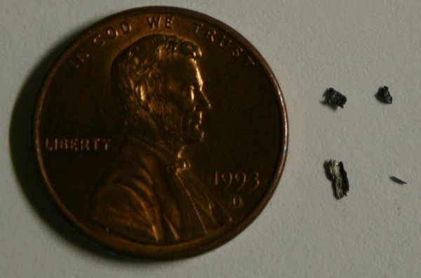

If I wiped a paper towel in a recessed area (an oil puddle), it came up with numerous tiny, silver specks in it. But the specs were so tiny that I couldn't even photograph them. And wiping down most of the oily surfaces in there yielded nothing but clean oil--only the puddles had some junk in them.
I did find four metal flakes in there. I'm not sure if they came from the windage tray or not! None were as large as Moby-Dick.
http://www.robroygregg.com/Number50/IMG_4413z.JPG
Here's a close-up of the largest of the batch:
And the inside of the driver's side valve cover. The same brushed area is there, so I'm guessing that's a factory thing for these covers.
http://www.robroygregg.com/Number50/IMG_4387z.JPG
http://www.robroygregg.com/Number50/IMG_4388z.JPG

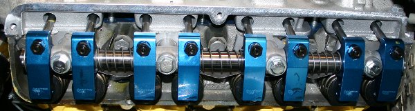

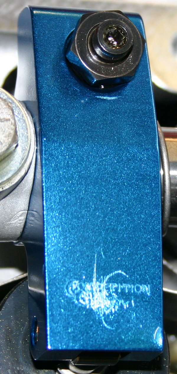

Notice the funny marks on the rocker arms here too!
http://www.robroygregg.com/Number50/IMG_4391z.JPG
A good shot of the head from above:
http://www.robroygregg.com/Number50/IMG_4405z.JPG
I can never remember how to increase my depth of field. Open aperture and increase shutter speed or close aperture and decrease shutter speed? Maybe that's beyond the scope of this book (or thread).
http://www.robroygregg.com/Number50/IMG_4408z.JPG

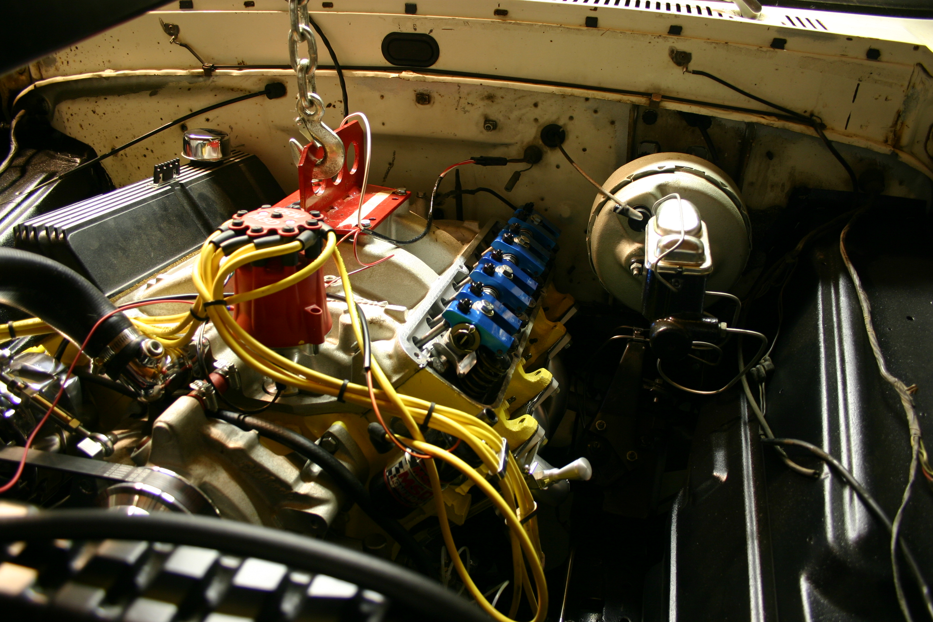

Photos of the general area, just for fun.
http://www.robroygregg.com/Number50/IMG_4390.JPG

Are those specks of metal on that rocker arm nut?

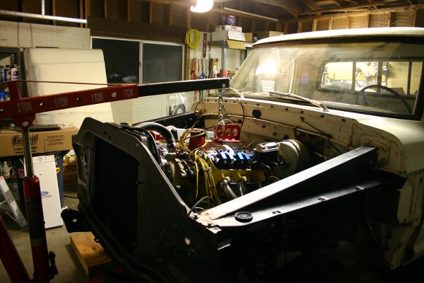

Robroy, at this point I would suggest pulling the motor and putting it on a stand so you can clean it thoroughly while rolling it over. Like '70 says, it looks like metal flakes all through the oil in the rocker arm closeup (what's the shiny bits on the spring retainer? air bubbles or...). Either way you shouldn't be finding chunks of metal in a fresh engine, even boring and hone work doesn't make chunks, just fine grit.
Also for future reference, pull the truck into a garage nose first. That way the exhaust is blowing outside and you can back the truck outside halfway to work on it. And when you lift the motor to remove you just push the truck out from uder it.
Seriously, as 70 said, stick a fork in it, it's done and needs to come back out, complete flush, bearings checked, etc. Far higher quality work when it's done on a stand. You'll be able to see that the bearings seat correctly etc and stuff won't be falling on your head and in your eyes while doing the work.

Oh, about the metal in the oil...
Yes, some is normal on a new engine, but if you can feel it that is too much. This is why you change the oil right after a cam break in and then again around 500 miles on most rebuilds. Big chunks like moby are not good, I was willing to let moby and his little friend slide because casting flash sometimes does break loose, but finding more is bothersome...
To replace the cam bearings you would have to take the block (bare by this time) to a machine shop, last time I had it done it was about 40 bucks plus parts (for a bit over 80 all in all IIRC).
Other than the cam bearings it should be a simple disassemble, clean, reassemble deal...
