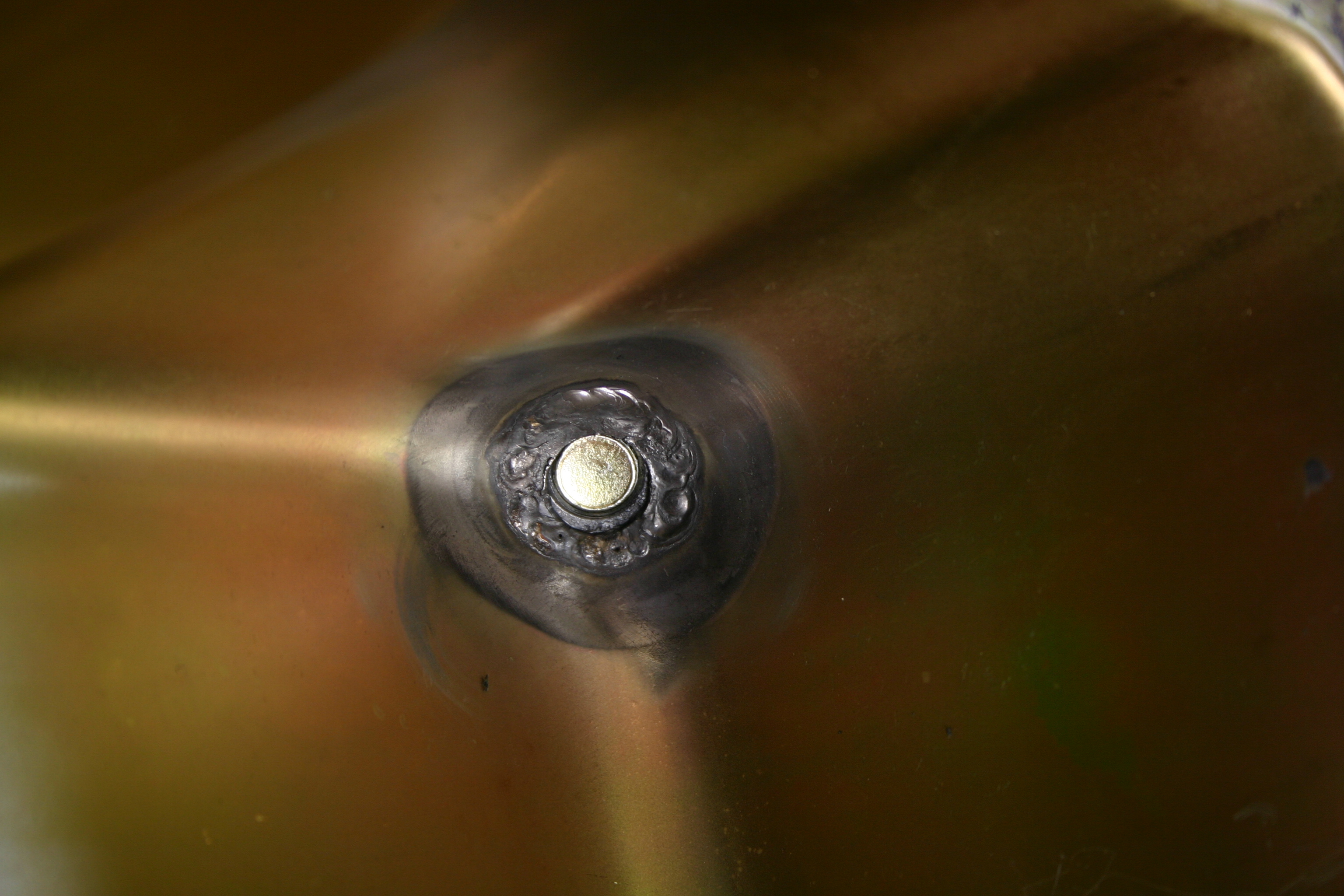

Hey Robert and Jamie thanks for replying!

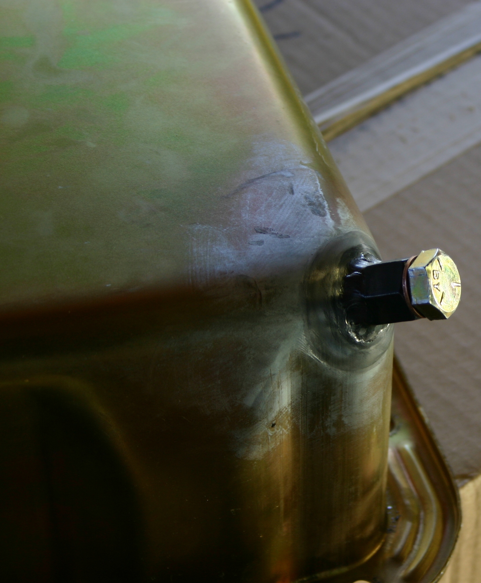

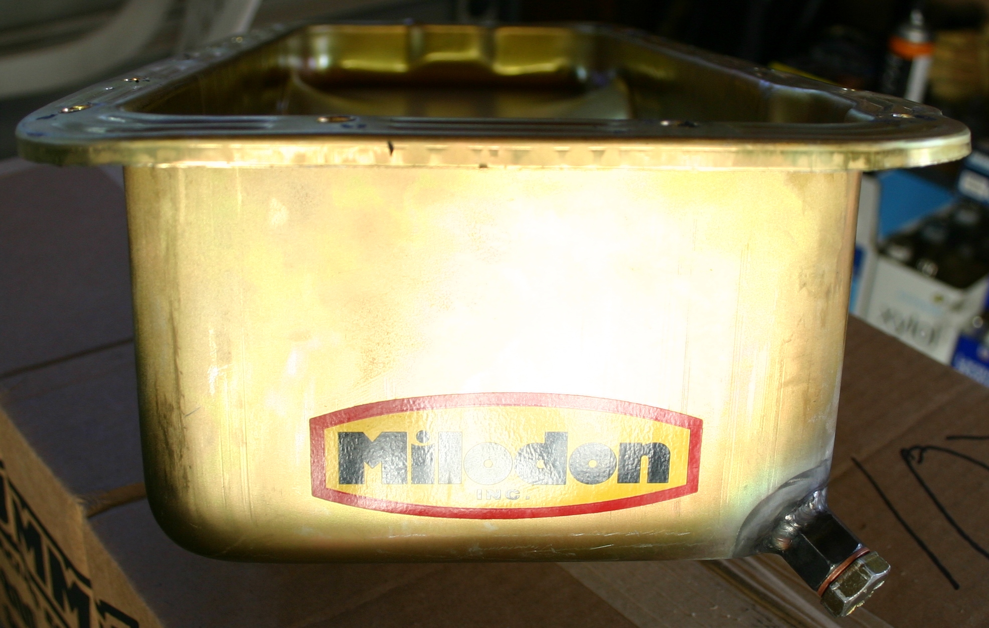

DuckRyder wrote:I don't think that is from the windage tray... the question is WHAT IS IT FROM?
I'm at a loss at the moment... :hmm:
After thinking it over, I realized that Moby-Dick looks a lot like the metal shaving that comes out of imperfect threads when a bolt's screwed in. Despite its height and width, it's quite thin.
DuckRyder wrote:You have the arrow pointing to the top of the cover, but it could be the corresponding casting on the bottom...
Whoops! Yeah I see what you mean.
DuckRyder wrote:The good news is that the oil doesn't look like metal flake from here...
Great! It looked quite good in person also. Moby-Dick and the other small (and tiny) specs I found were only uncovered as the result of an insanely detailed search.
Ranchero50 wrote:Moby looks like a chunk of casting flash (dark grey cast iron) where from? Who knows.
Ah, yes it does look like that I suppose! I may have to put Moby in an envelope and put it in my mailbox addressed to, "FBI."
Ranchero50 wrote:Heck, what's another valve cover gasket at this point?
True! I'll take a look.
Ranchero50 wrote:I'm not sure about the rocker marks, looks almost like someone was sloppy with a spring tension checking tool but why would you check it after it had run. Wonder what Steve thinks?
I'll ask Steve at the next opportunity and let ya'll know! Maybe I'll wait to ask him until I hear back about the warranty extension though--no need to pull his tail with minor stuff until then. Then I'll pull it. :)
Thanks Robert and Jamie!

Is it just me or does that valve cover look like someone has been buffing on the top of it with a rolock wheel (sanding pad).
As long as I didn't find any cracked bolt bosses or anything I think I might be inclined to ignore moby and his little freind... It is too large to have been pumped up there and that sort of thing is why you change the oil pretty quick on a new build...
The scratches on the rockers are puzzling, I really don't see how they could have hit the cover and the rear ones are still clearing the baffles...? Jamie may be right it could have happened during the build for some reason...
Robert

Hey Fordman and Robert, thanks for replying!
fordman wrote:is that large chunk metal or rubber or what kind of matieral is it.
It's a hard, dull gray metal. I tried to bust it up with a machinist's pick and it stayed together.
fordman wrote:my first guess is part of a valve seal.
Is this guess along the same lines as that big crack you find in my new T18 top plate? :)
DuckRyder wrote:Is it just me or does that valve cover look like someone has been buffing on the top of it with a rolock wheel (sanding pad).
Yes! That's no an optical illusion in the photo; it really looks like that. I assumed it was done at the factory. I'll compare it to the other side tomorrow!
DuckRyder wrote:As long as I didn't find any cracked bolt bosses or anything I think I might be inclined to ignore moby and his little freind... It is too large to have been pumped up there and that sort of thing is why you change the oil pretty quick on a new build...
Okay doke! I'll look all around for damage and otherwise happily ignore these artifacts.
DuckRyder wrote:The scratches on the rockers are puzzling, I really don't see how they could have hit the cover and the rear ones are still clearing the baffles...? Jamie may be right it could have happened during the build for some reason...
Indeed! Maybe I'll put a small amount of paint on one or the other surface and rest the valve cover on the head. Then if the paint transferred from one surface to the other I'll know something's up. On the other hand, the transfer might only take place during a particular phase of the engine rotation.
This just reminds me of your initial assessment of #50's engine sound, when you thought it sounded like two noises (a sheet metal noise and a valve noise).
By the way, I'm really impressed that you guys knew that the noise was sheet metal!

My first reaction was:
"Guess we know what the other noise was now..."
But on second look nothing really makes sense, it looks as if something spun or slipped off... maybe thats where Moby was... I just don't know... :?
Robert

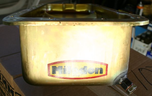

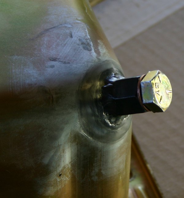

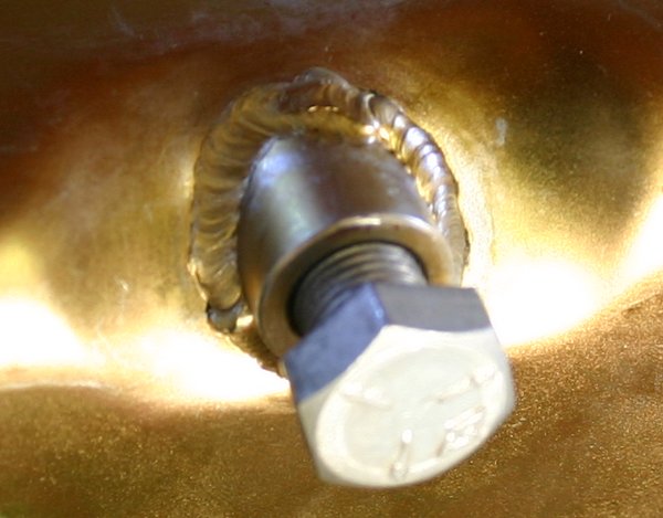

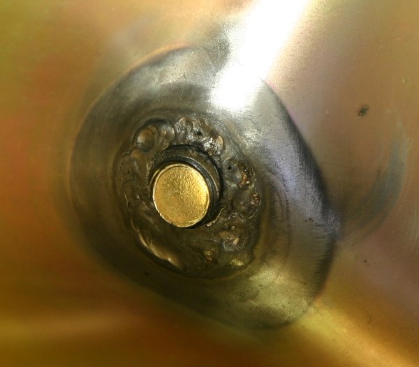

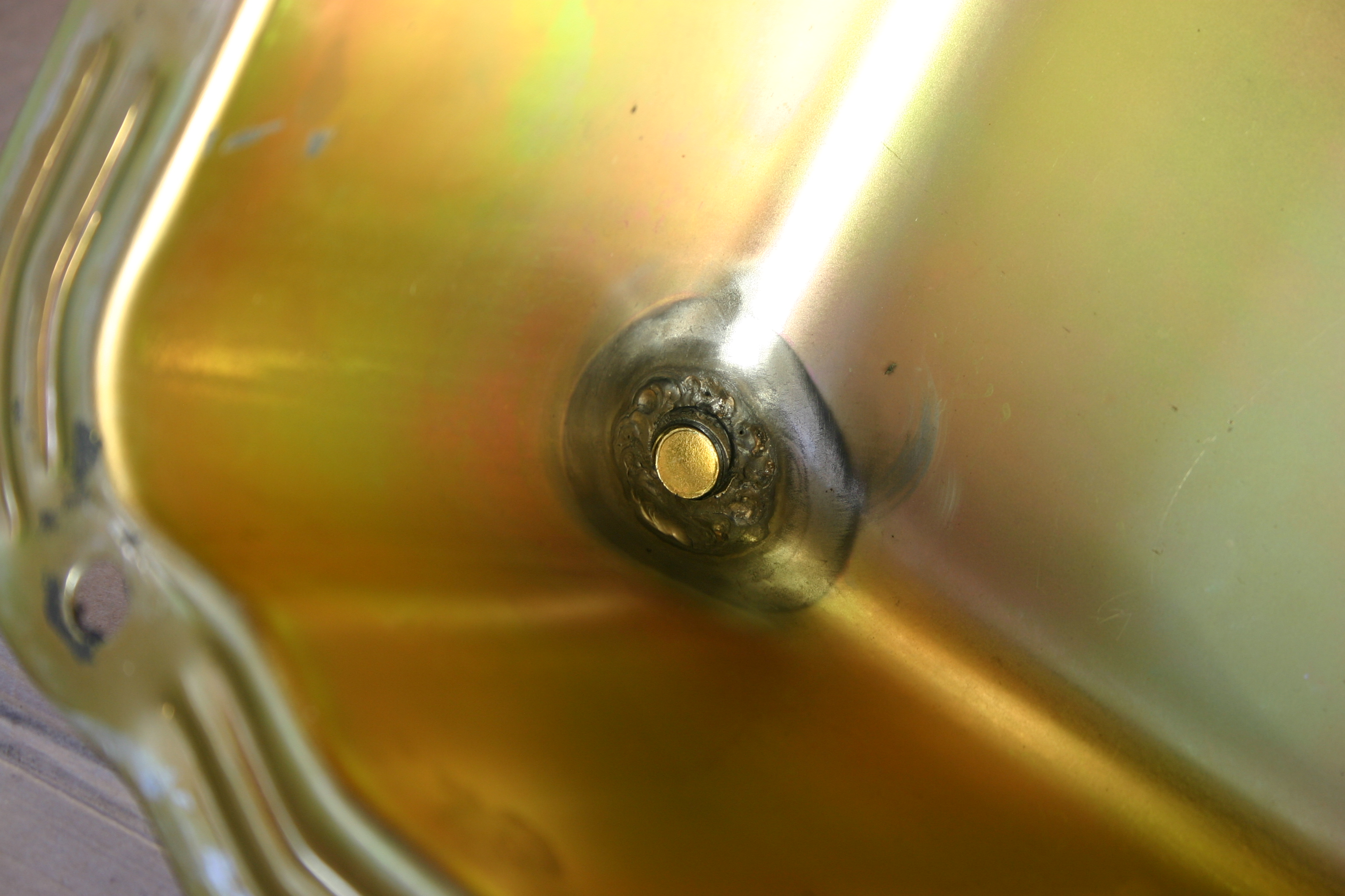

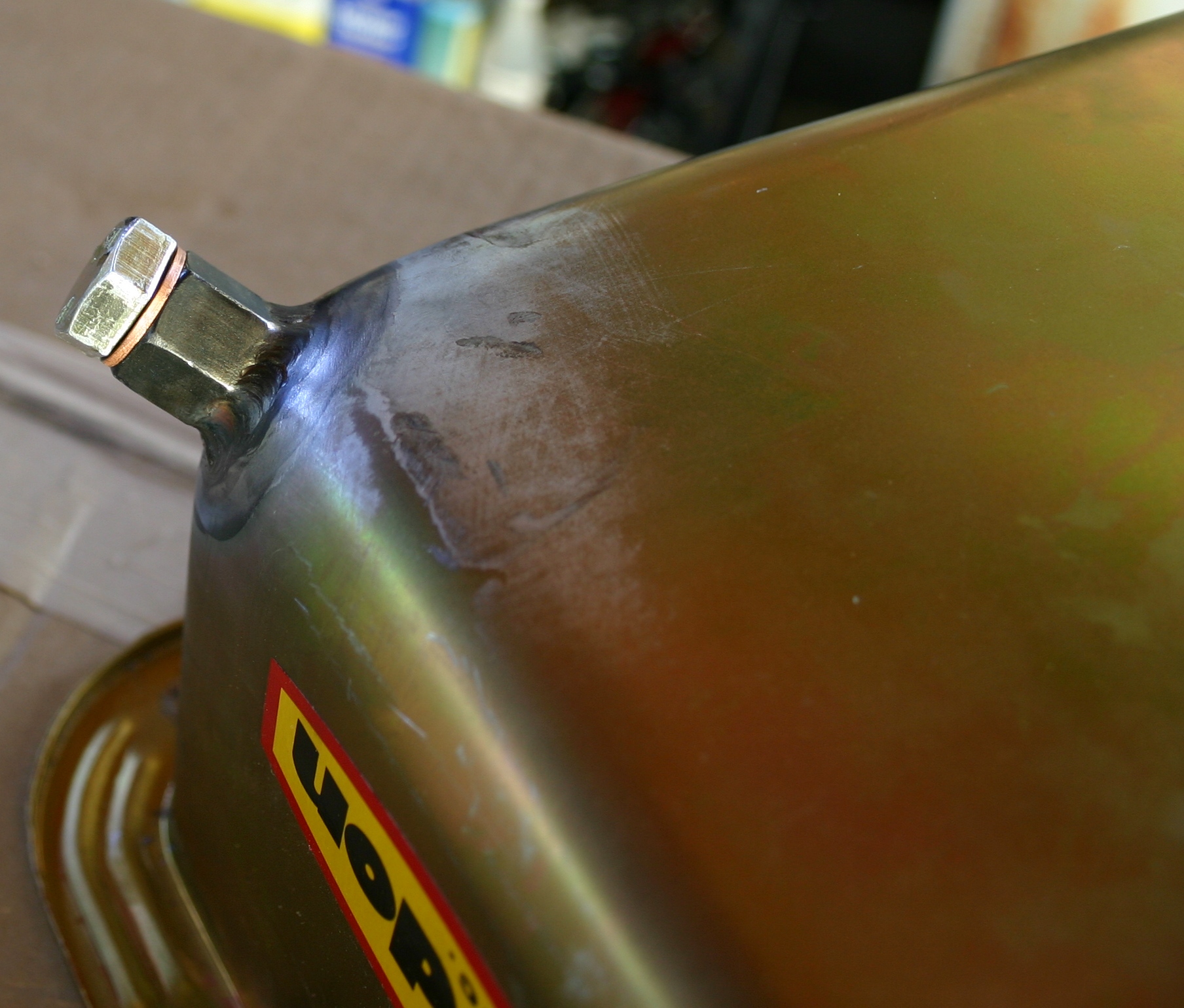

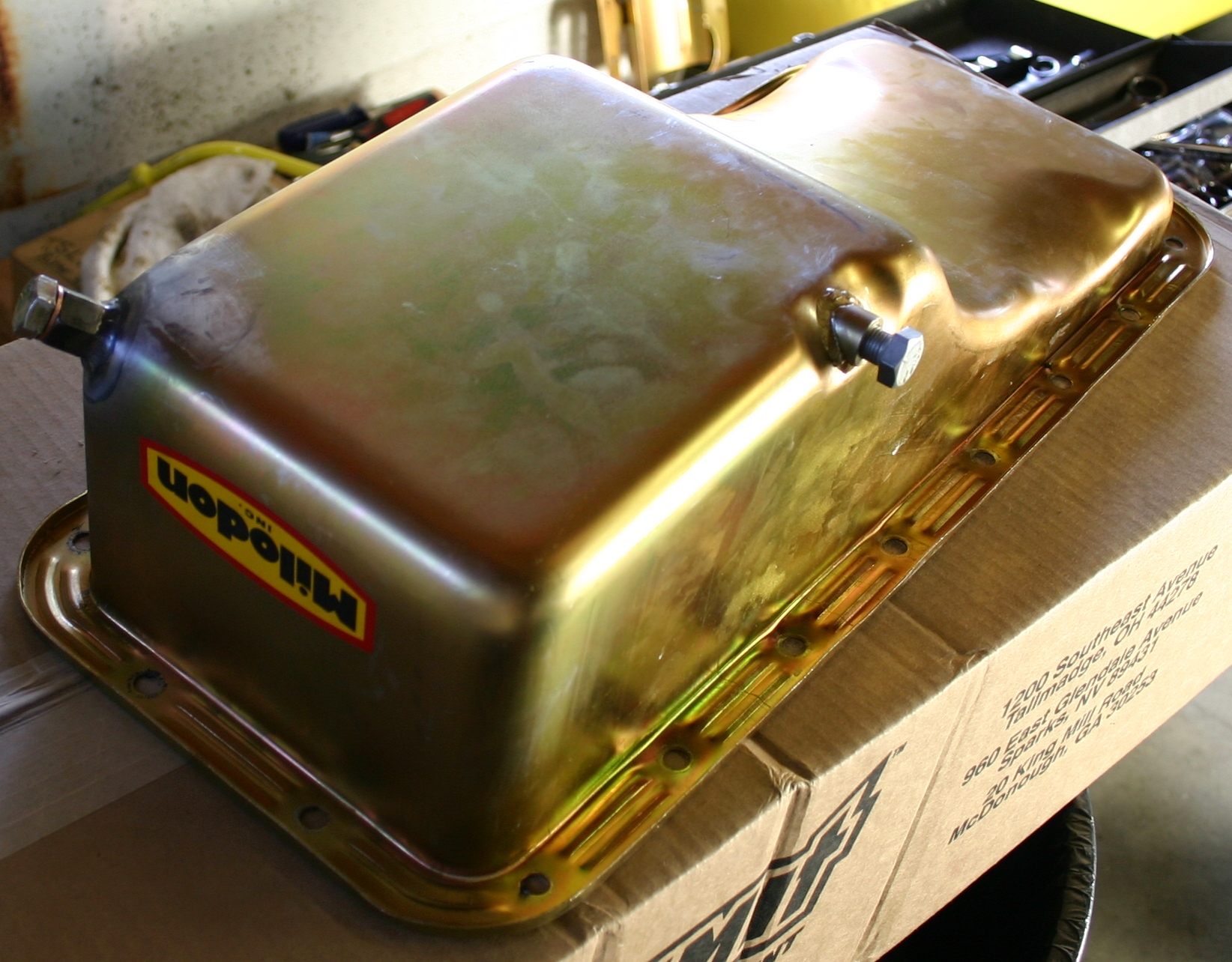

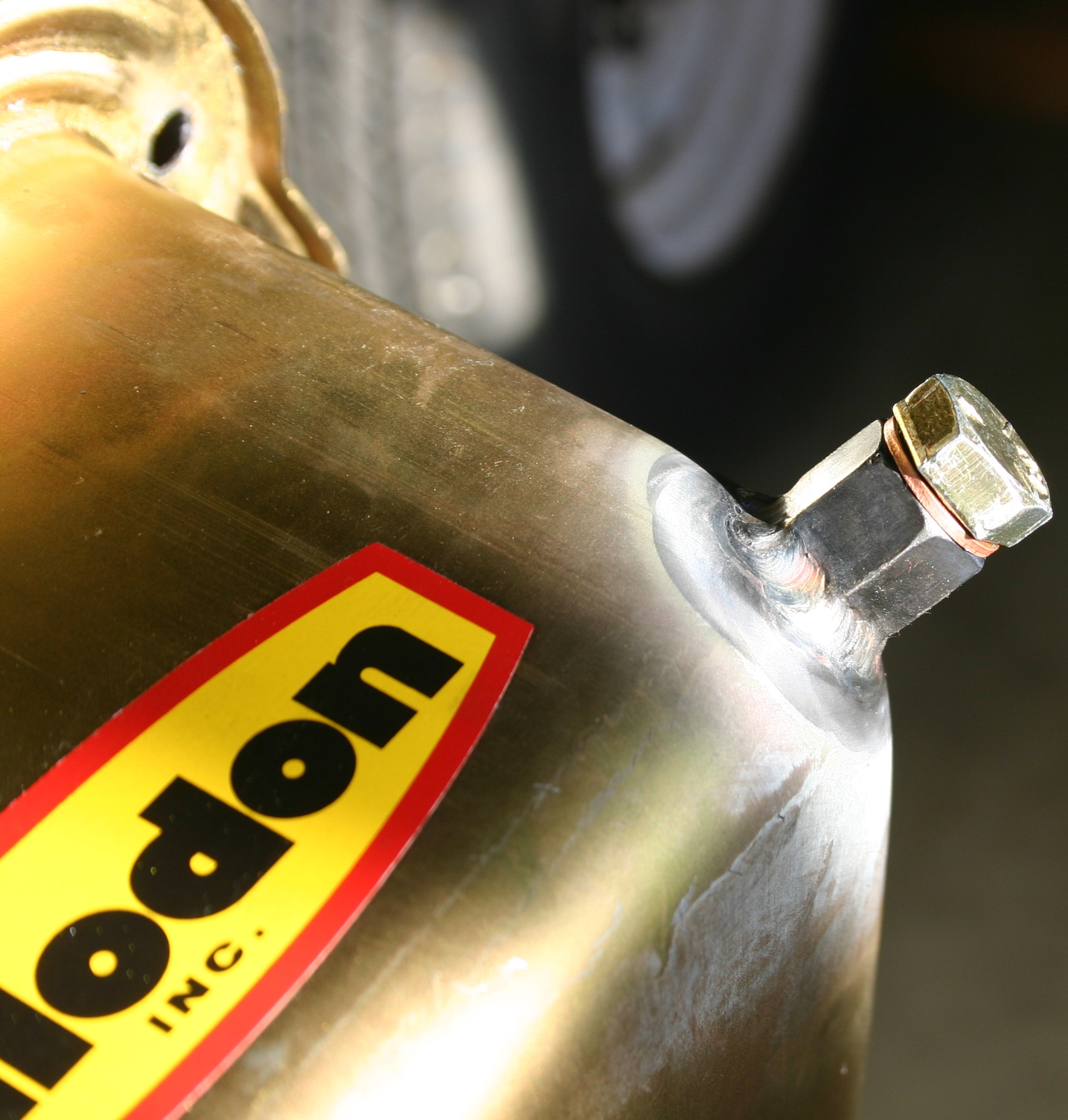

Today Valley Fabrication in Salinas added a second drain plug to my pan! They did it in about an hour and charged $43.61.
See it there, on the front corner?
http://www.robroygregg.com/Number50/IMG_4358z.JPG

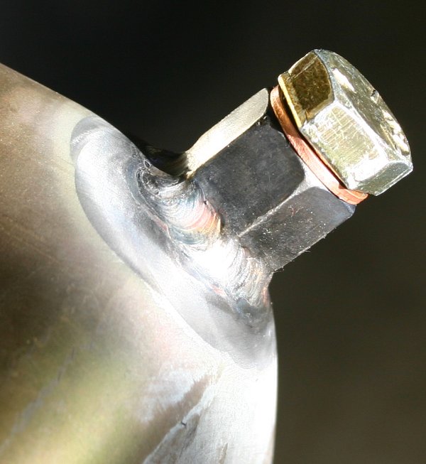

They used a big nut instead of making a piece of threaded pipe, so it doesn't look exactly like the Milodon one, but that was OK with me. They offered to make it look exactly like the Milodon one for an extra $20 or $30, but I didn't think it mattered.
http://www.robroygregg.com/Number50/IMG_4357z.JPG
http://www.robroygregg.com/Number50/IMG_4362z.JPG
http://www.robroygregg.com/Number50/IMG_4360z.JPG

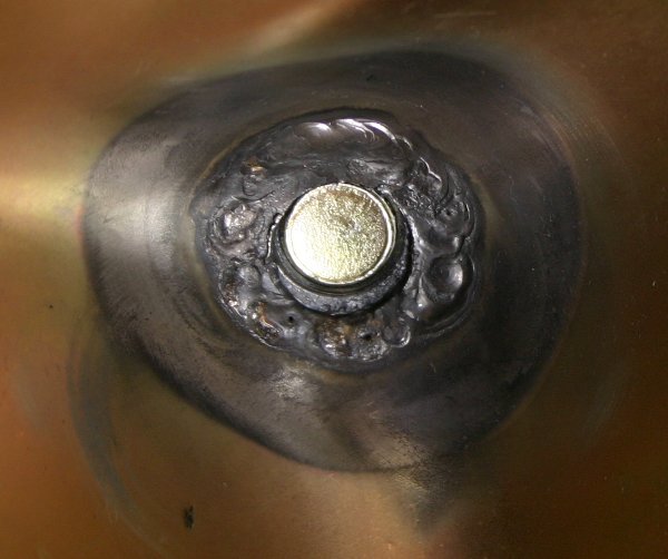

The inside didn't turn out quite as pretty as the outside, but I think it will be OK. I was a little concerned about the irregular surface catching bits of metal while the oil's being drained. Do you think it matters much?
http://www.robroygregg.com/Number50/IMG_4364.JPG
http://www.robroygregg.com/Number50/IMG_4365.JPG
Here's how it will look, sticking down at that angle, when installed on the engine.
http://www.robroygregg.com/Number50/IMG_4367z.JPG

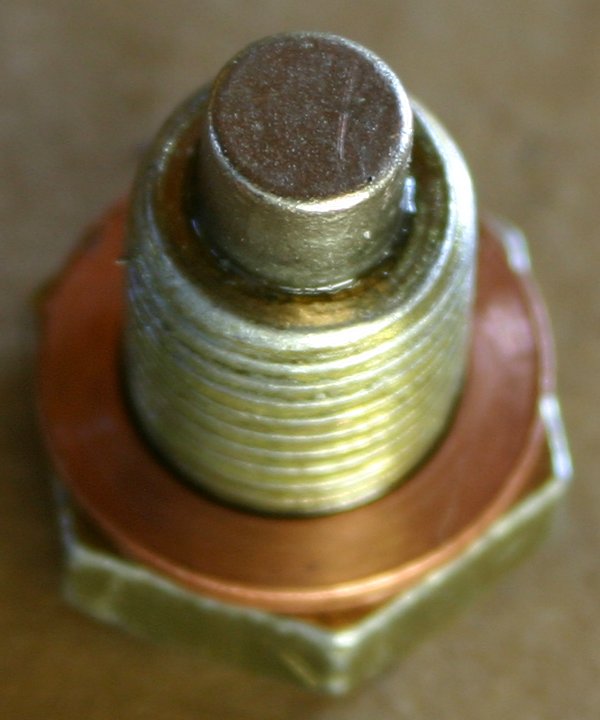

Here's the factory drain plug, for reference.
And here's the drain plug I'll be using. That magnet on the end is STRONG.
Since the new drain isn't at the lowest point in the pan, I'll have to change my oil with the truck on a hill if I want to get it all out. That doesn't bother me as much as oil splashing all over the crossmember!
Thanks very much for the valuable guidance, and stay tuned for more updates!
